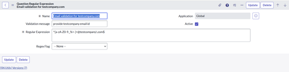

You can create Regular expression in ( question_regex ) table. As mentioned below.

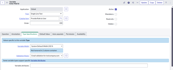

Expresssion : ^[a-zA-Z0-9._%+-]+@testcompany\.com$
Now in catalog item select single line text as a variable and in Type Specification section there is field called validation regex in that select regular expression which you created above in question_regex table.
Please mark my response as correct and helpful if it helped solved your question.
