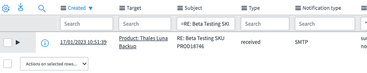

The conditions are matching, but the record is skipping and attaching/updating the wrong record because of the record number in the subject. Can we skip this check? There is no watermark on the body as well.
The subject has the record number of another table (Product Table), which is getting updated/attached.
example - RE: Beta Testing SKU PROD18746
