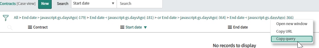

You can navigate to list view for that table and filter as you need. Once the filter is built accordingly, you can right-click the last piece of the breadcrumb and choose copy query, then paste that between double-quotes for your line, for example:
cnt.addEncodedQuery("paste_here");
endsRELATIVEGT@dayofweek@ahead@179^endsRELATIVELT@dayofweek@ahead@181^NQendsRELATIVEGT@dayofweek@ahead@364^endsRELATIVELT@dayofweek@ahead@366
The above is an example. Please take this information and go from here.

You can use one scheduled job to search for records whose expiry matches your conditions of 30/60/90/180/365, etc.
As far as the filter that I built, it's just using the "relative" operator and then use 1 day on either side of the specific value. Example:
  • End date "relative" after 29 days from now
  • End date "relative" before 31 days from now
Then insert an "OR" and then build the next set:
  • End date "relative" after 59 days from now
  • End date "relative" before 61 days from now
Once you've built all filter conditions, you can right-click the last piece of the bread crumb trail, copy query, then paste as your addEncodedQuery between double quotes as I've stated above.
