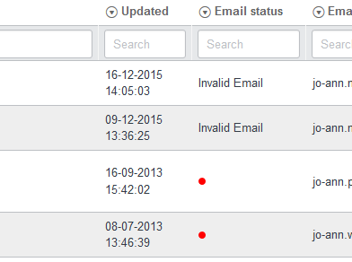

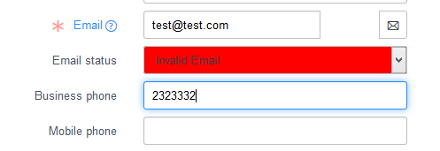

‎12-15-2015 08:08 PM
without any value, the color red will apply to form view, but in list view it applies to field with a value entered, (see below)
Form view
List view
It would be great if we know value to be set so the condition applies to form view when the value is 1 which is Invalid Email.

‎12-15-2015 08:52 PM
Thanks Manjul, your suggestion works like a charm. did not realise the client script has to come and play in the form style formatting.
Many thanks.
