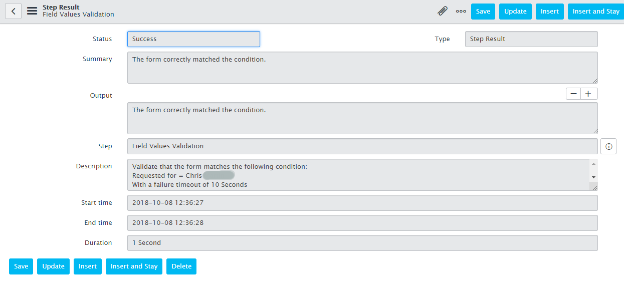

However this field is below the fold so it doesn't appear in the screen shots produced by ATF so I have modified ATF to raise a record producer in my name 'Arthur Ansell' and then changed the validation to check for a colleagues name instead of mine. I would expect the test to fail, but it still passes? Here is my setup:

4. Here is my validation - deliberately checking the wrong name.
5. So as before i would expect the validation to fail? But it passes with the output below:
So is it possible to explain this?
