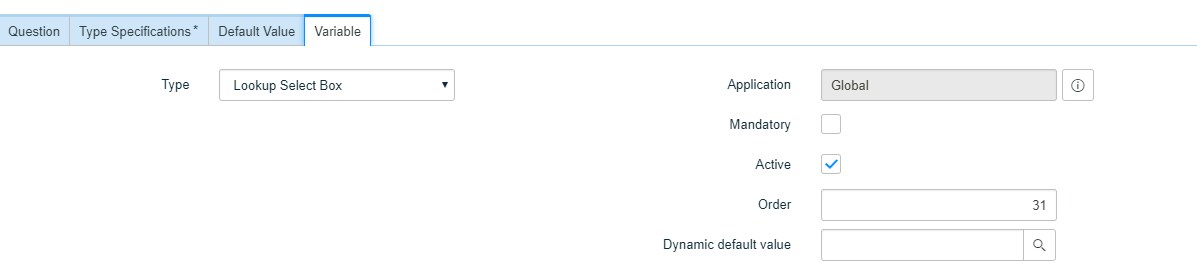

The reference qualifier field is not available for a Lookup Select Box.  Do you have to modify a UI Policy to get it to show up?
