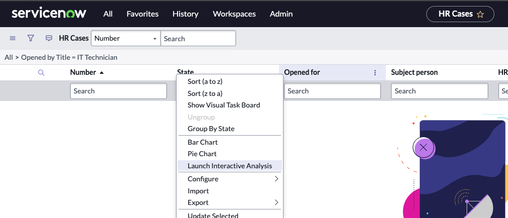

Hello @yoli1 ,
You can achieve it either from the list view or directly from the Report as well.
If you have already applied your filter on the list view, it is much easier to do it from the list view.
Simple, Right-click on any field you want to create a report on (See image attached) and click on the Bar chart or Pie chart option.
ServiceNow will create a report for you with the filter you added to the list view of HR Incidents.
Once done you can change the report type and configure the report as per your liking.
