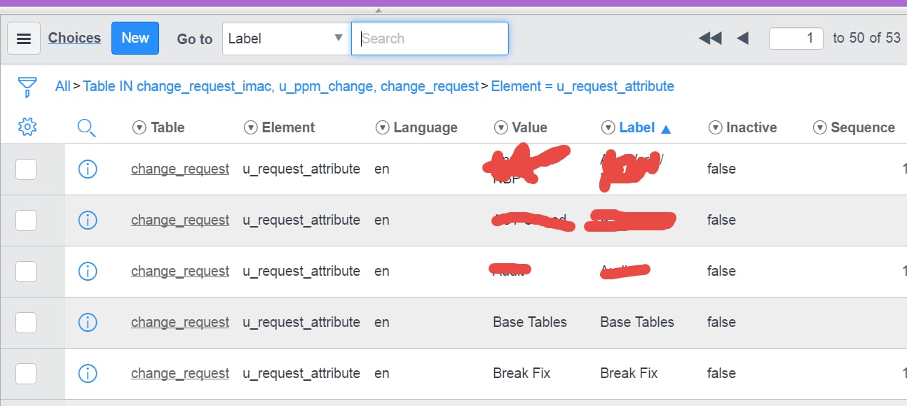

Hi everyone,
How can I filter the available options in the condition builder? When I click on the value look up, it shows me the list of all Choices from all Choice Lists.
However, I just want to see the choice list of Change attribute field. In other words, I want to see the filtered results just like the one in the 2nd screenshot below, instead I get the 1st screenshot.
Any help is appreciated.

By default the values will be all the values on the table, as your essentially just doing a lookup to the choice table records.
Generally, add a filter you need to add a reference qualifier to the list field dictionary entry with condition such as 'name' 'contains' 'change'.
