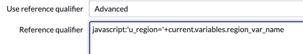

It sounds like your "two drop down fields" are actually two variables on a Catalog Item that have the type of reference.  Assuming this is the case, since the reference table of the locations variable (cmn_location) contains a field (u_region) that is a reference to the selected region, all you need to do in this case is to add a reference qualifier to the locations variable that looks something like this:
Using the name of your region variable obviously.
