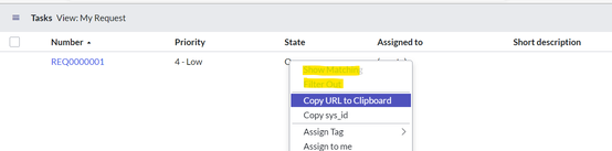

How can I enable filters show matching and filter out in the my requests? Thank you!

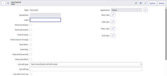

Btw, filters are not omitted in the list control.

Hi I tested in PDI, this is OOB behavior, the my request module is set up on Task table, hence there is some ACL or condition restricting the show matching, it works fine when you change the table from task to sc_request. the filters show up

Hi, I tried all of these but none of them worked.
