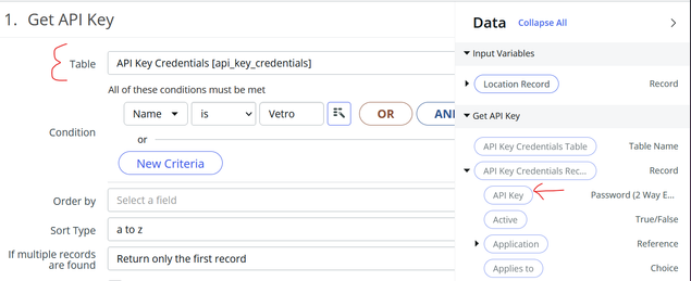

Yes, the first step is to use 'Lookup record' against the 'API Key Credentials' table, like so:
Notice that the 'API Key' field is then available in the datapicker.

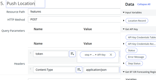

Then, in the REST step, I was able add the API Key as the value to the 'token' header:
So, this workaround is secure and still as easily maintainable as using a connection alias, as the actual value of the API Key is still abstracted away from the flow itself.
