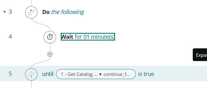

The "Wait for condition" action in Flow designer is not designed to be used like that.
It's required that you choose a record to make some evaluation on.
Instead you could use looping function do the following until, and there have a condition that checks if the variable is set to true, and within the loop wait for some amount of time.
Example as follows:
