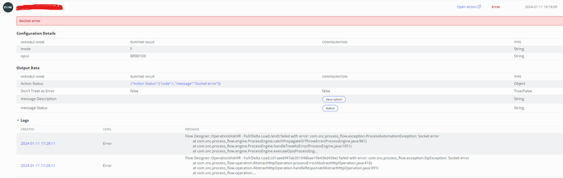

I created a flow to send a REST message to an API, requesting some records and inserting them into a staging table.
When I run the workflow, the actions that send the request begin processing, and after 5 to 10 minutes, it generates the following error message:
However, even with the error, my staging table is still receiving the records.
Can someone help me please?
Thank you

Hi @Andr_1
Please check if below post helps :
https://support.servicenow.com/kb?id=kb_article_view&sysparm_article=KB0815903
Also, you can try increasing the glide.http.outbound.max_timeout property.

Hello @vermaamit16
Thank you for your help.
I already have this property mentioned in the article
and related to the glide.http.outbound.max_timeout property
I don't have this property created, but it takes the default value (30) and it can not be higher than 30.

Hi @Andr_1
Did you validated if the endpoint requires SNI support or not as mentioned in the support article ? If not, please try to mark the tls enabled system property to false and check.

Hi @vermaamit16
It did not work
