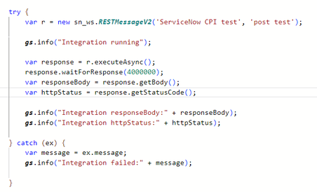

But, to try your suggestion, I created an script to do a rest message
I set the "glide.http.outbound.max_timeout.enabled"  to false and used the waitForResponse() in the script. I put also a log to see the response body, and it gives me an error:
"An internal error occurred. For error details check MPL ID AGWhciSbtst0D7H1VnYS2Dp9L4Tg in message monitoring or use the URL ..... to directly access the error information"
Hi @Andr_1
Are you calling a SOAP endpoint in the "ServiceNow CPI test" Rest message ? Most probably, you are getting this error from the endpoint not from ServiceNow.

I did not... I simply change the approach and right now I am not using flow design anymore. I am calling the api via script, and inside the script I am including the code to run on asynchronous mode
