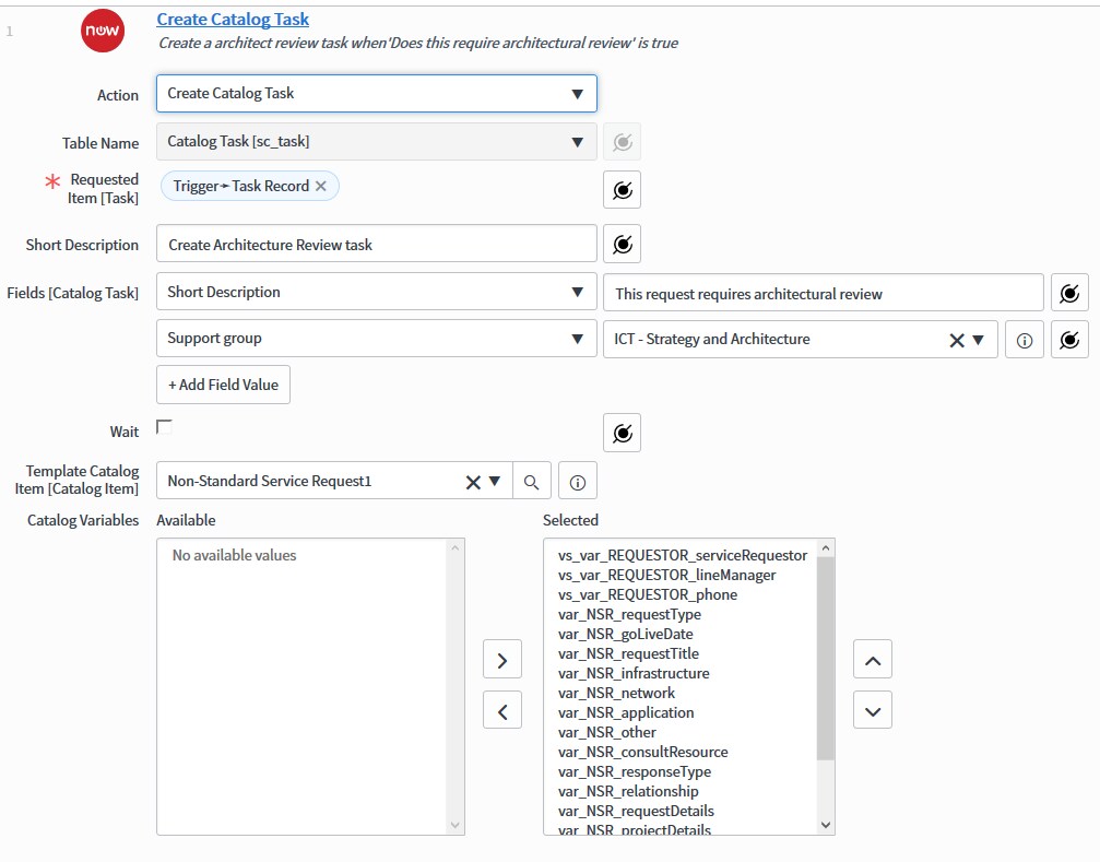

I'm in the process of creating my first flow in Flow Designer and I'm getting an error when I run the test, which I need some help with.
Scenario:
Trigger
If catalog item is Non-Standard Service Request1 &
task Short description is Awaiting Implementation &
Catalog Task Does this require architectual review is true
Action
Create new catalog task
Trigger
Action
When I test the flow (on an sc_task that meets the trigger condition) I get the below error.
I don't what is wrong and how to address the issue.
Any help would be appreciated

I do have that plug in on, but my issue with it, is that I can't set the trigger I want.
I need to add more conditions to the trigger other than 'Service Catalog'
I need -  if  catalog is a and category is b and item is c and sc_task is d and when question on sc_task is and answer e
then create new sc_task.
I can't find a way to this when the trigger is Service Catalog.
