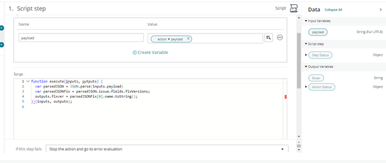

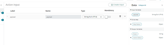

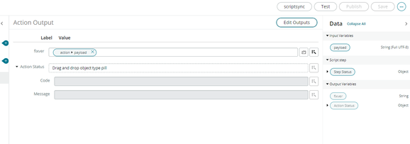

Hoping you can help me... I am trying to retrieve the fix version from the jira issue into a new field I created on the task.
I have followed your steps about the Flow Action:
Here's my action:
If this is correct above what do I need to do in my webhook to get the fix version into the task
