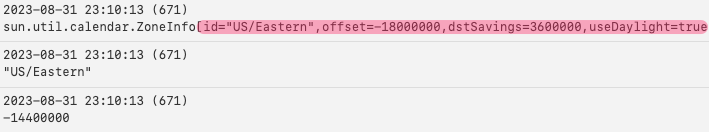

Here's a more accurate method:
gs.print((gs.getSession().getTimeZone()) + "");
var tzName = gs.getSession().getTimeZoneName();
var tzOffset = new GlideDateTime().getTZOffset();
gs.print(tzName);
gs.print(tzOffset);
This is the output:
If you use "getTimeZone", you have to parse the results like you did, which is always dicy.  The other problem is you then need to figure out if DST comes into play or not and add the "dstSavings" to the "offset" time to get the true current offset, which means more parsing.  That's hoping to get 4 bits of info properly.  -18000000 + 3600000 = -14400000, the true offset, which "getTZOffset" gives you.
