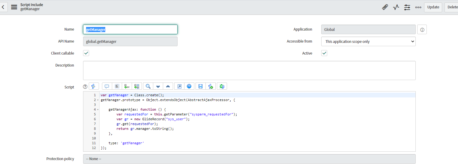

Hi Harun,
Attached are 3 screenshots of my code. One of the screenshots will show the error I received.
Update:
I see why I was getting the error. I udpated the code from "gr" to "ga". No error but the manager field did not pull up when a requested for user is selected.
