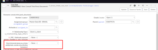

Recently I'm having a lot of difficulty with the following question: I'm having to hide a form field,
But the validation must be done on top of the parent's variables.
But, not the form variables, but those that the user selects on the portal.
How can I do this?

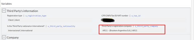

The variable I have to hide (This is the Case Task)
The variable I have to use as validation (This is the Case)
