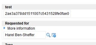

I added another field - a text field this time, again with a default value of javascript:gs.getUserID() and queried on it. It is working as expected. That's why I think it might be an issue with the field being a reference field.
[edit]: OK, so a quick update:
I changed the above text field 'test' to a reference field and it is working. When the user has MyCompany in its source, the department number changes.
It is not working on the requested_for field, however.
