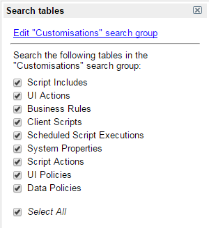

Global Search
I would recommend setting up a global search for customizations. I included the following tables:
Type in the field name into the global search and you'll find pretty much every reference!
Administering Global Text Search - ServiceNow Wiki

If it is a script variable you should be able to paste it into the Global Search at the top right corner of your screen. And all of the applicable search results will come up in the Policy section.
