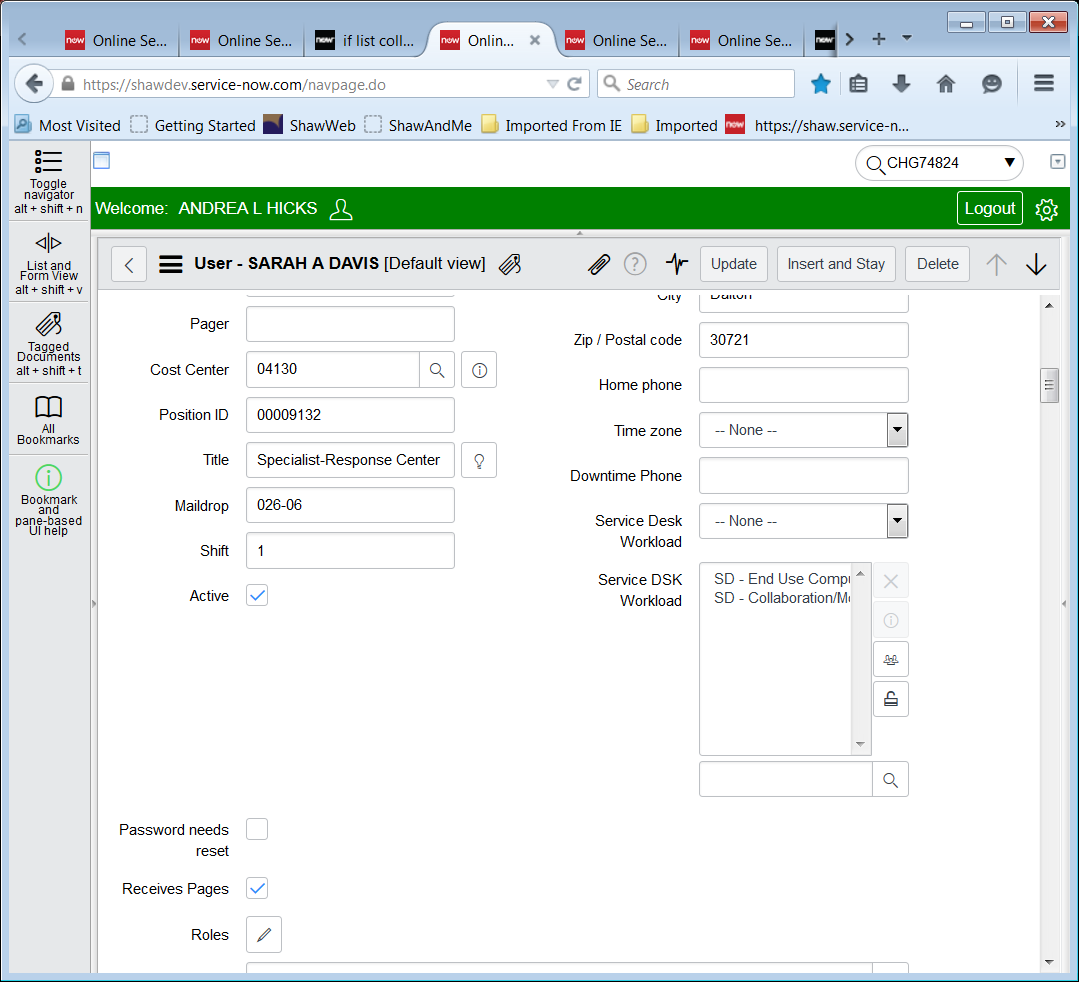

Thank you for the quick reply, that didn't seem to work either.   Here's a pic of my old field and new field.
var assignTo = getLowestUser();
//gs.addInfoMessage("assigning to is " + assignTo);
current.assigned_to = assignTo;
function getLowestUser() {
var userList = new Array();
var cg = new GlideRecord('sys_user_grmember');
cg.addQuery('group', current.assignment_group);
if (current.assignment_group.getDisplayValue() == 'SD - Collaboration/Mobile') {
//OLD FIELD
//cg.addQuery('user.u_service_desk_workload', 'SD-Collaboration/Mobile');
//NEW FIELD
cg.addQuery('user.u_service_dsk_workload', 'IN',   '591f507cf07d4d0c0f323fc297cb7d10');
//cg.addQuery('user.sys_user.u_service_dsk_workload', 'IN',   '591f507cf07d4d0c0f323fc297cb7d10');
//cg.addQuery('user.u_service_dsk_workload', 'LIKE', '591f507cf07d4d0c0f323fc297cb7d10');
//cg.addOrCondition('user.u_service_dsk_workload', 'CONTAINS', '591f507cf07d4d0c0f323fc297cb7d10');
//cg.addQuery(user.u_service_dsk_workload.toString().indexOf("591f507cf07d4d0c0f323fc297cb7d10") >-1);
cg.query();
while(cg.next()) {
var tech = cg.user.toString();
//if (cg.user.u_absent != true){
//if (cg.user.u_service_dsk_workload.toString().indexOf("591f507cf07d4d0c0f323fc297cb7d10") >-1){
//if (cg.user.u_service_dsk_workload, 'LIKE', '591f507cf07d4d0c0f323fc297cb7d10'){
var cnt = countTickets(tech);
//gs.addInfoMessage("Tech counts " + cg.user.name + ' ' + cnt + " " + tech);
userList.push( { sys_id: tech, name: cg.user.name, count: cnt } );
for(var i=0; i < userList.length; i++) {
//gs.addInfoMessage(userList.sys_id + " " + userList.name + " " + userList.count);
userList.sort(function(a, b) {
//gs.addInfoMessage("Sorting: " + a.sys_id + "(" + a.count + "); " + b.sys_id + "(" + a.count + ")");
return a.count - b.count; });
if (userList.length <= 0)
return "";
return userList[0].sys_id;
function countTickets(tech){
var ct = new GlideRecord('incident');
ct.addQuery('assigned_to',tech);
ct.addQuery('active',true);
ct.query();
return ct.getRowCount();
