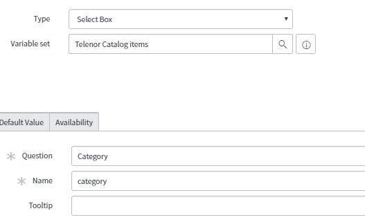

What is the type of variable you are trying to add options?
It is a variable on a variable set:
