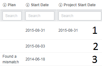

Both date fields are basic, no time.
Case 1 = Expected Positive
Case 2 = Expected Negative
Case 3 = Earlier Test with simple addQuery

And it found a match! Variable string was different but you're right once I grabbed the query from the filter and used encoded it worked. Thank you so much.
