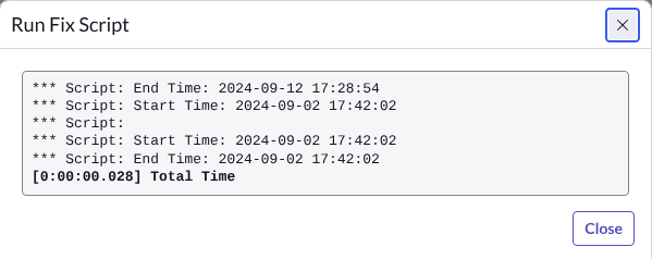

My script looks good, but the results I'm receiving are not what I'm expecting. Here's the script:
var startTime = 0;
var endTime = 0;
var grMetric = new GlideRecord('incident_metric');
grMetric.addEncodedQuery('inc_number=INC0007001^mi_definition=35f2b283c0a808ae000b7132cd0a4f55');
grMetric.query();
	while (grMetric.next()){
		if(grMetric.mi_value == ("Resolved")){
			startTime = grMetric.mi_start;
			gs.print("Start Time: " + startTime);
		}else if(grMetric.mi_value == "Closed"){
			endTime = grMetric.mi_start;
			gs.print("End Time: " + endTime);
	gs.print(" ");
The attached file shows the results. How is the variable 'startTime' being overwritten? Any suggestions.

Nick Parsons
Your endTime (and startTime) are references, so they change on the next iteration of your loop when ServiceNow repopulates the property grMetric.mi_start to the value from next record. Can you try adding toString() to the end of your property access when storing the values? eg:
endTime = grMetric.mi_start.toString();
 Also, for debugging, it may help to differentiate the log text in your loop vs the logs outside of your loop so it's clear what's printing what (gs.print doesn't always log in the order it's used).
It's to do with how ServiceNow reuses the object references each time .next() is called. Internally, when you call .next() it updates the GlideElement's value (but reuses the same GlideElement object reference), and since endTime stores just a reference to the GlideElement, it changes too.

crowe1288greg
I made a slight mistake. The variable 'endTime' is the variable that is being overwritten. How?
Nick Parsons
Thanks Nick. That worked!!
Can you help me to understand how the variable was being overwritten before the script change.
