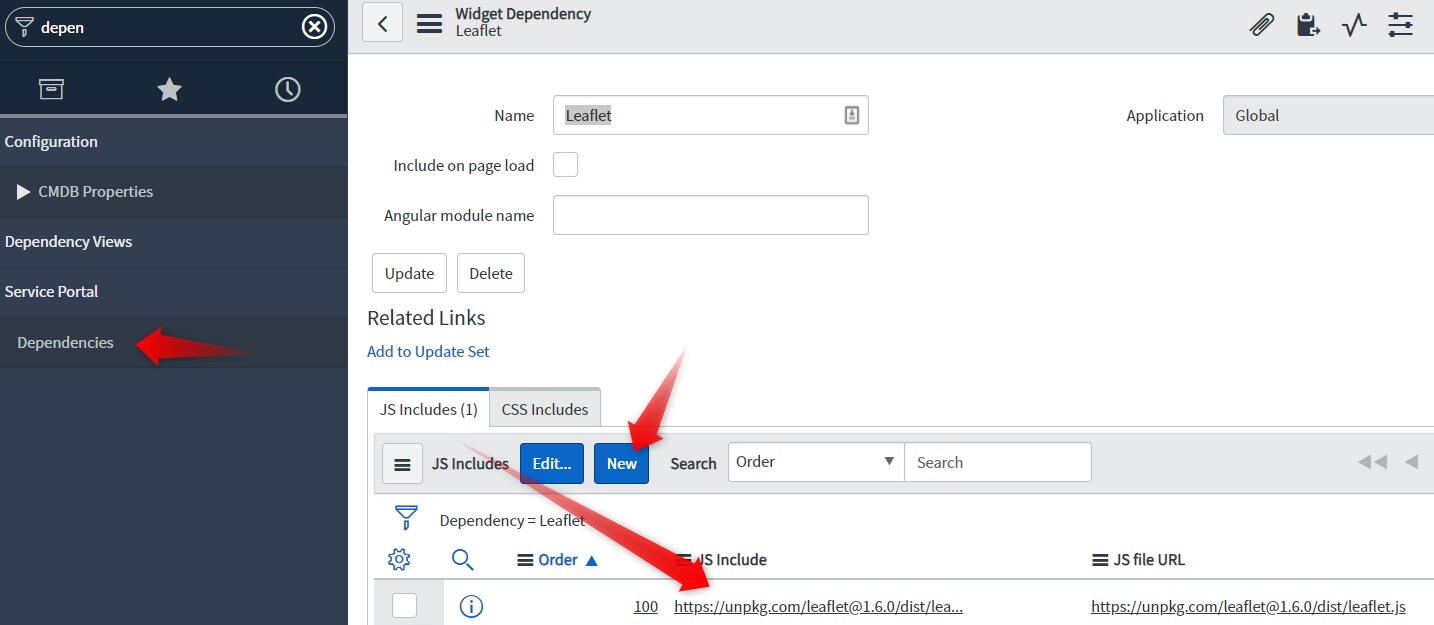

First thing I did was create a new widget dependency named Leaflet.  Then I created a new JS include that points to the URL of the of the leaflet library (https://unpkg.com/leaflet@1.6.0/dist/leaflet.js).  Though, it would be better to have a local copy of the library for your JS include.
