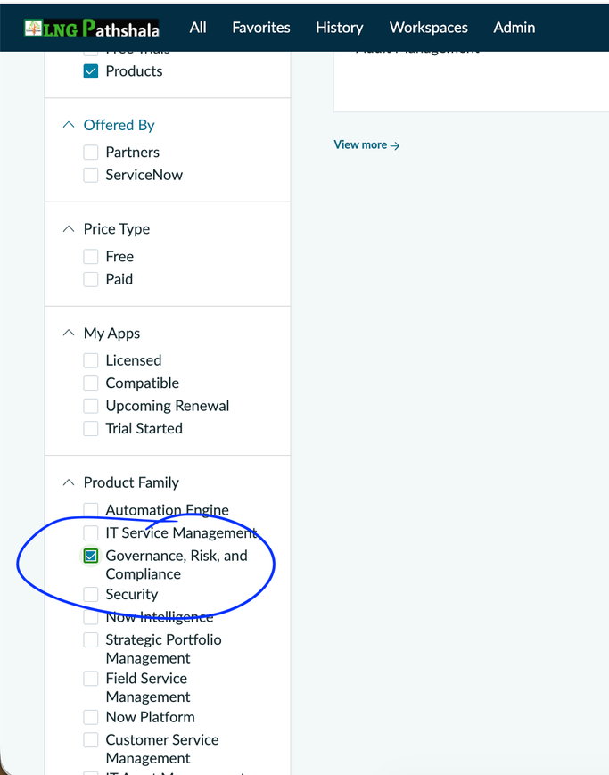

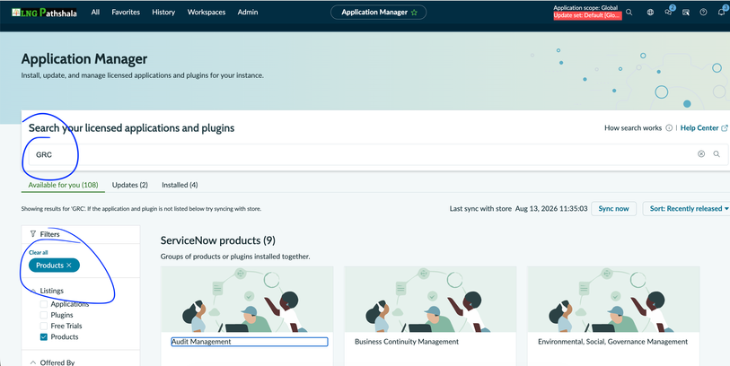

Hi there @JGouvisis
I can see these plugins, pls check if they are already installed in that case they will be under installed and if it doest work try searching with plugin ids instead.
try searching with this

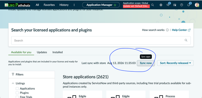

Hi @JGouvisis
Don’t release the instance , as the waiting time might be quite high—possibly a day—and you may not get an instance immediately afterward.
Before doing that, you can try the following:
- Try syncing the plugin once.
- Log out and log back in.
- Check again to see if the issue is resolved.
If the issue still persists, then we can consider resetting the instance.
08-13-2026 05:07 PM
Thank you! I have followed your instructions, found and installed all plugins. I appreciate your help!
