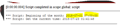

I just worked the above code and its giving me the correct response.
Thanks.
Thanks Omkar, But why it is giving you 07:00:00, shouldn't it be 2018-07-01 00:00:00?

Shweta KHAJAPUR
check once the time zone selected.
Shweta KHAJAPUR
select time zone to us/pacific or GMT and try once.
