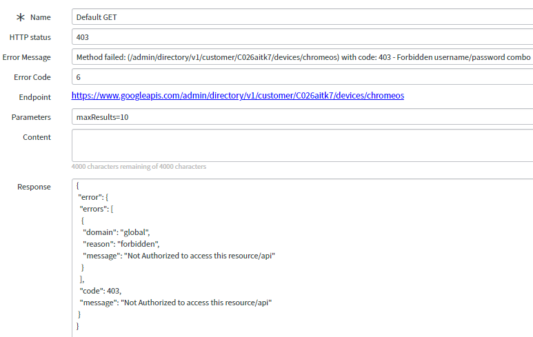

At my client, we would like ServiceNow to read the groups as they are registered in GSuite. I run into an issue with this integration, as i seem to receive a OAuth token, but when i use it i receive a 403 error
From the google docs, i understand that you should (more or less) "impersonate" a user. However, i'm not sure if this is mandatory when using a Service Account in google. Because google created a service account, i do not have a client secret and client ID, but had to compile a .jks file from a certificate and use a JWT integration.
Any assistance will be greatly appreciated, as currently I think i tried everything i could think off.
Below a description of my configuration.
Using the JWT Provider and Application registry, I registered the credentials our Google team provided. Using these credentials I am able to click on the Rest Message (sys_rest_message) "Get oauth Token" which will show "OAuth token flow completed successfully" in the pop up. When i click on "Test" on the HTTP Method (sys_rest_message_fn), however, I receive this:
HTTP status: 403
Error message: Method failed: (/admin/directory/v1/groups) with code: 403 - Forbidden username/password combo
Error code: 6
Response:
 "error": {
  "errors": [
    "domain": "global",
    "reason": "forbidden",
    "message": "Not Authorized to access this resource/api"
  "code": 403,

The integration is up and running now. This is my resolution:
1. Ensure the "sub" claim is filled with the email address of the admin
2. if you receive the error "OAuth flow failed. Verify the configurations and try again. Error detail:invalid_scope, Invalid downscoping, scopes should not be specified as a request parameter" re-configure your scopes:
  • add a custom claim  "scope" to your "JWT Provider" (space separated list of scopes)
  • on the Application Registry record (oauth_entity), add the "Oauth entity scopes" record (same as in claim)
  • make that on the "OAuth entity profile" the related list "OAuth Entity Profile Scopes" is EMPTY

In addition to the above..
When I wrote the last post I did not have the correct customer ID, but I did get manage to get the token-request working by removing the sub claim.
However, now having the right customer ID in a HTTP request that consumes that token against the actual Google API resource I do get the same error as you did:
But what was a solution for you (adding the sub claim admin user), prevents my logic from getting a token in the first place, so now I am stucked again..
Any ideas?
