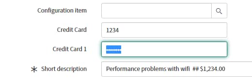

As ServiceNow is running on ECMAScript5 so you are getting the null value. To accomplish the requirement the best way as of now is to use .toLocaleString()  in the Client Script. As Client Script will use Browser JavaScript version so this is possible on Client-side scripting.
Below is the dummy code:
        return;
    var num = new Number(g_form.getValue('<your_field>')),
        sd = g_form.getValue('short_description'),
        result = num.toLocaleString("en-US", {
            style: "currency",
            currency: "USD"
    g_form.setValue('short_description', sd + ' ## ' + result);
From the Script Include you are going to receive error/undefined results.

Thank you. This is my exact problem. I think I'll use a UI script and see where that gets me.
