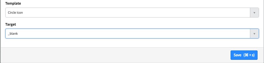

Options allow your users to configure individual widget instances. Defining a target option allows you to set the target for each icon link individually if implemented. Here is how I tested enabling this.
1) Open the widget in the widget editor. You can find this by going to /sp_config, clicking widget editor, and searching for "Icon Link".
2) Click the menu icon and click "Clone Icon Link" to create a copy of the widget called "Icon Link with Target". This is necessary because out of box widgets cannot be modified.
3) In the new widget click the menu icon and click "Edit option schema."
4) Click the + icon to add a widget option as follows:
Label: Target
Type: Choice
Choices: _blank, _self (These are the two answers that make the most sense. The other two I was able to find were _parent and _top but those are for frames which we're not using here.)
Now when you use "Icon Link with Target" instead of Icon Link you'll see the option to set a target. Setting it to _blank will cause the links to open in a new tab.
Go ahead and test this and make any modifications as necessary. Please note that I've only done some quick testing on my own instance, so you'll want to make sure this is working 100% before moving forward into a production instance.

11-14-2016 08:27 AM
This worked PERFECTLY.
Thanks!
