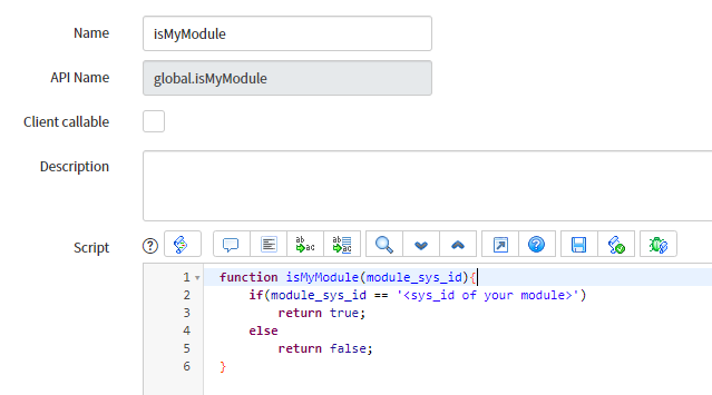

@dpacheco you can also try to create an onDemand Script Include and pass it the sys_id of particular module for which you want to hide the applied filters, as shown in the image below;
Then call this onDemand function in the condition of your Business Rule as shown in the image below;
Here sysparm_userpref_module is the URI parameter which stores the sys_id of any opened module.
Hopefully, this will also help you resolve your query.
