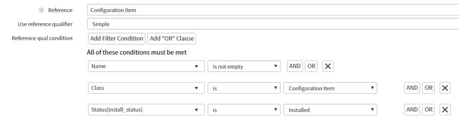

Thanks for the reply. I've been able to get it to work for Incident, but it isn't working for Change Request. Here is my initial dictionary entry:
Both my overrides are using the following logic as a test:
install_status=1^sys_class_name=cmdb_ci_win_server^ORsys_class_name=cmdb_ci_linux_server
As stated, it works for incident but not change. I'm guessing this has to do with the change CI's being a related list (as below), rather than a reference lookup field like we are using in incident.
If my guess is wrong, any thoughts on why the code isn't working? Assuming the related list is the issue any thoughts on how to customize that for all users so when we go click the 'add' button, we can still filter the list to specific classes?
