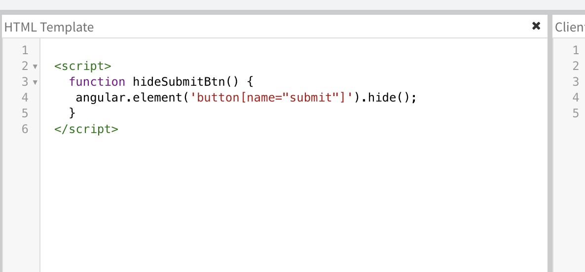

      3. Declare below function in your custom widget (software development tool)
  and call this function from UI policy whenever you want to hide. Note : you can add another function for show.

Hi Chirag,
I am trying Option 3 that you recommended.   Hope this is correct?
Added this code to my Widget:
<div>
<body>
<div id="sample_check"> <font><b>You are in the incoorect form. Please click </font> <a href="https://[InstanceName].service-now.com/sp/?id=sc_cat_item&sys_id=21caf3ba0ff04700b855f08ce1050e47"><b><font color="Blue">here</font></b></a><font> to be redirected to the right form. </b></font>
</div>
</body>
</div>
<script>
  function hideSubmitBtn() {
      angular.elemement('button[name="submit"]').hide();
</script>
Then add this to the UI Policy that calls the Widget.
But it is not working as intended.   Ideas or did I do your step incorrectly?
-Wesley
Please check Run script in Ui type field and it should be All/ Mobile or Service Portal.
Yes, tried "Mobile / Service Portal" and "All" with no success.
