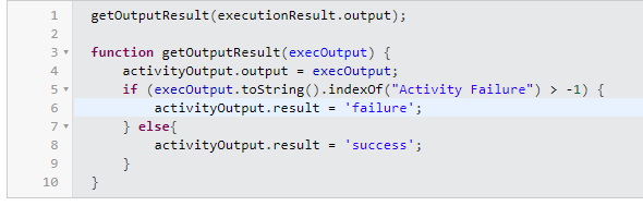

In my post processing currently i am handling failure and success like :
"Activity Failure" I mentioning in catch in power shell script.
My question is : how i can handle error in workflow to take workflow at failure path when i face error like in ecc queue.
