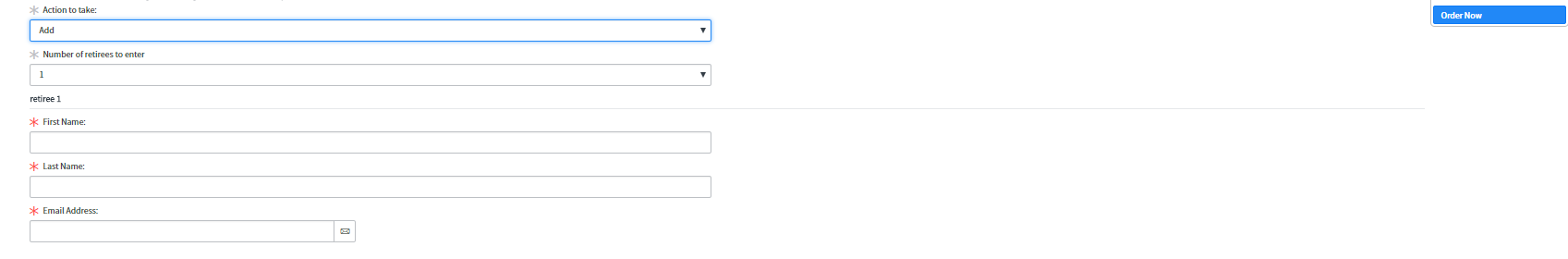

I have created a variable set, then clicked on the generate multiset within that variable set. I then added that multiset to my form. Which shows up like the below. While making the multiset i decided that i would only let 10 instances of the variables set show up. the variable set being made up of first name, last name, and email for each instance.

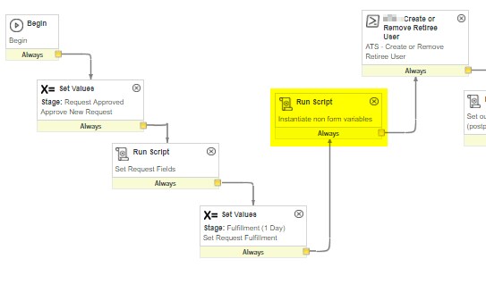

While working in workflow editor, i am using a run script action. All i want to do is within that run script action, is get the inputs that were added to my form, and pass them to a custom powershell script action.

After talking to my collegue i found out that multiset's are part of a third party update set that you can add to your instance. Is there a out-of-box way to allow someone to create multiple sets of these three variables? for example.
Retiree 1
FirstName:
LastName:
EmailAddress
Retiree 2
FirstName:
LastName
EmailAddress
Etc.
But only show the amount of Retiree forms based on the number of retirees you want to add to a table? If so 'd rather use the out-of-box as much as possible.
