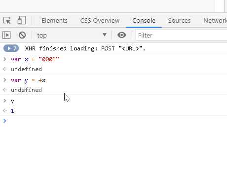

Try to add plus infront - if your variable is x = "0001" try with  y =  +x   - this will cast it to number and loose the leading zeroes

you can use the regex replace method for this, see below. FYI GlideRecord isn't supported / recommended in client scripts.
var num = "000012455";
var a = num.replace(/^0+/, '');
a;
better is
var a = +num;
