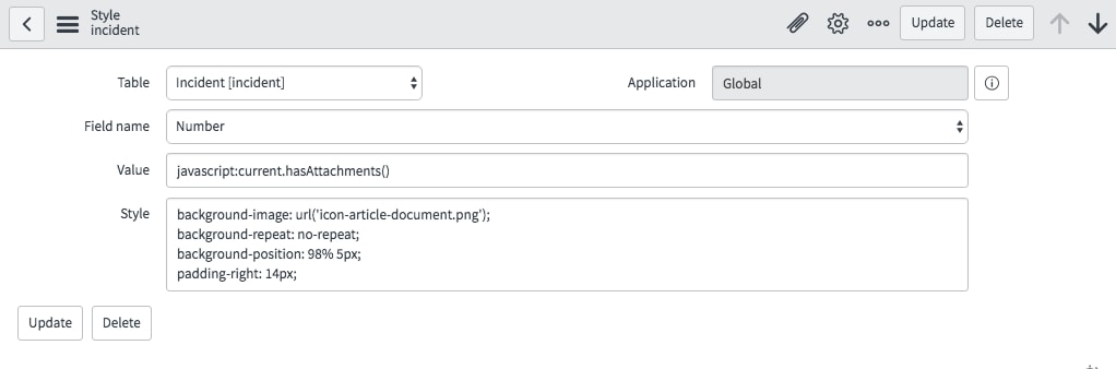

Another way that is possible is using the hasAttachments() on the sys_ui_style table for the record. For instance if I wanted an icon or color change to indicate that the record has an attachment in the list view I could setup a style like so:

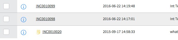

And if the record has an attachment it will display like below (I didn't have a paperclip icon 😞
(Notice the little yellow document icon)
I know, aesthetically it's not all that pretty. But it's an option. Perhaps maybe if the field were just an empty field and then this style placed on that field it may look better.
