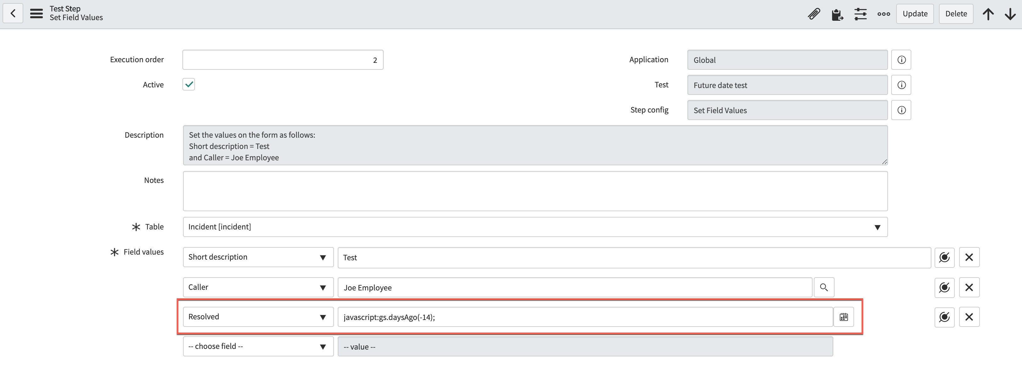

The easiest way I've found to do this is to use something like gs.daysAgo() or gs.hoursAgo() in the date/time field like this:
Using a negative number sets a date in the future, so this would set resolved to two weeks from when the test is run.

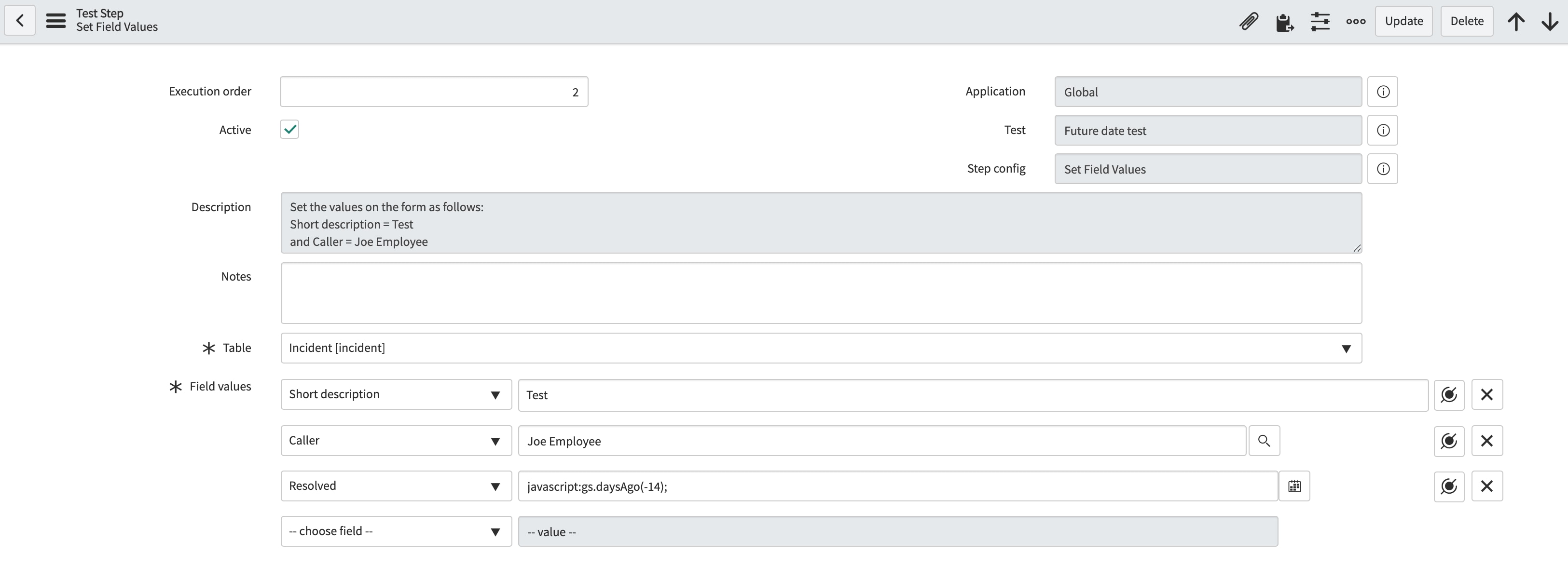

Hi Tara,
Hi Brad ,
Is there a function which set 10 minutes or 20 minutes in future from the current time .
Something like gs.minutesAgo(-10) should work.
Thanx a lot .It worked .
