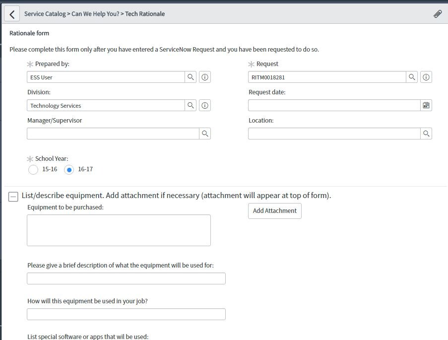

Does anyone know how I can get this to update a specific RITM?
Say I have a field in   in a from in the service catalog asking for the Request Item # - and then I want the information filled out to be added to that already existing RITM?

Thank you Thomas!
I think I am missing something though -
I want the fields in this form:
to be displayed on this form when submitted:
Similarly to the Variables that are already listed... is that possible? I am not seeing how to get them to display. OR if you have any suggestion on another way to achieve this...
