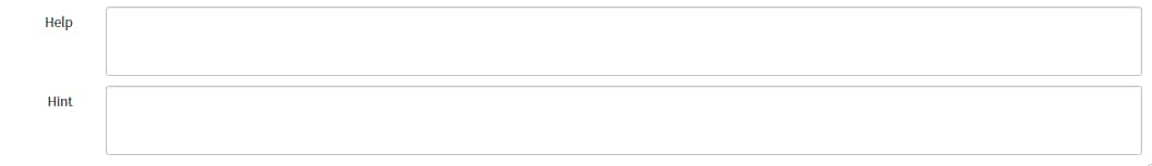

Hello, we have an application we are building that has as requirement of having some greyed/washed out text in a string field to provide more information which gets overwritten when you write into the field.
The field should say 'Please provide a detailed explanation of the purpose of this travel as well as a justification of this travel.'
The field looks as follows:
I've checked the dictionary of the field as well as configure label option and cannot find a way to add this.
The help and hint fields are NOT what we want to use, it's unreasonable to assume the user is going to know to hover their mouse over the field label to see more information to pop up.
We need this washed out text in the field textbox itself, similar to how you can do in catalog item variables using 'example text'.
