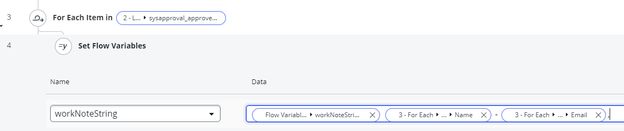

Sure.  It'll look a little like this
The first thing is to put the Flow Variable itself into the Data.  That will ensure through the loop it will just keep adding stuff to itself.  Then add a space, then add the Approver's Name space-dash-space Approver's email.  You just drag those values from your data picker on whatever node your For Each Item is on.
Then end with a comma.
At the end of the loop it will look something like.....
bob loblah - bob.loblah@bingobangobungo.com,  jorgen bjorgen - jorgenbjorgen@bingobangobungo.com, juan carlos chung - jcchung@bugnostroclumfanclub.com, chad broski - chadbroski@alphachadbro.ru,  etc etc
