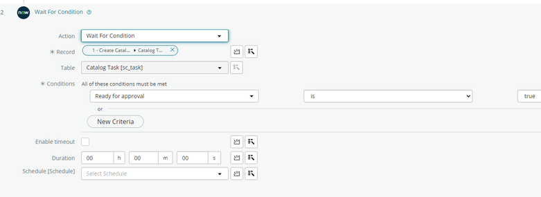

I have requirement to generate approval for sc_task, if variable in sc_task updated as 'true' then I should generate group approval for that task using flow designer. Can anyone help me to add wait condition until  variable got updated in sc_task?

Kai Tingey
if you are using a flow to create the catalog task:
set the create catalog task activity with wait = false, so it will proceed to the next step of the flow
add a wait for condition activity where it looks at the sc_task record and the condition is (your variable = whatever)
e.g.
it will wait until that field is updated to the value you specify and then move on to the next activity, which you can make an ask for approval activity, and set the group accordingly.
Because 'wait' was deselected in the task creation, if noone is going to be actioning the catalog task beyond the approval, then you'll need to add an activity to update that record to state = complete or whatever fits your requirements.
if there is no flow until approval is required, then you can just set the trigger to record updated , table = sc_task, filter (your variable = whatever).
hope that helps
