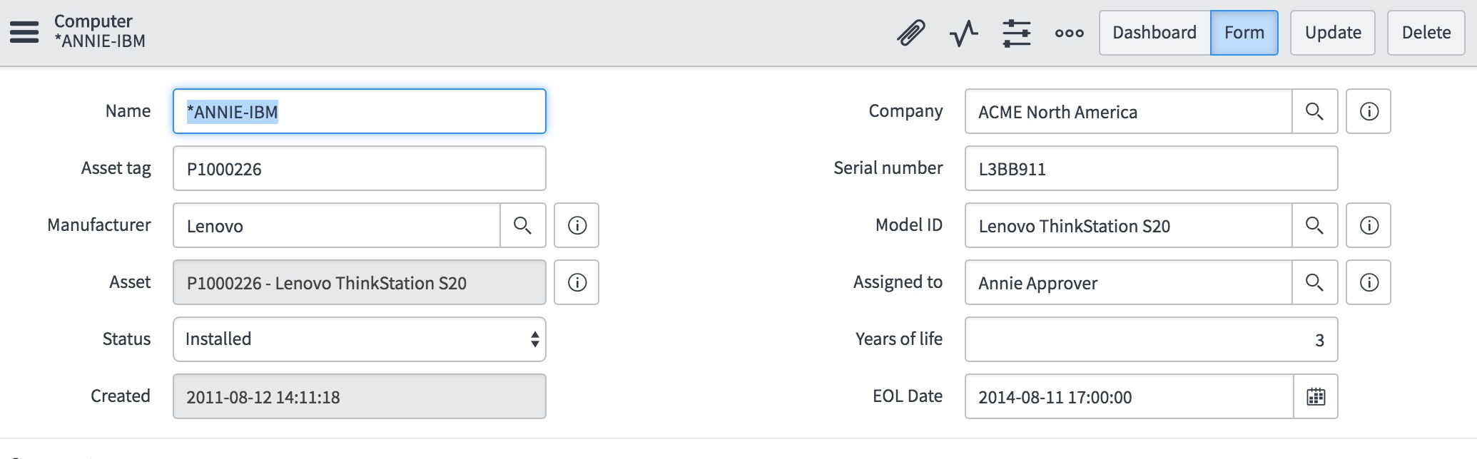

Here is my bus rule script. I want to populate automatically the u_eol_date (date/time field) with the sys_created_on date (date/time field) PLUS the u_years_of_life value (integer).
Notice on the form results below, it works to some degree, though it is short by a day and the time is a bit off. Not a biggie but wondering how to get it right. Also is a bus rule the best way to do it?

Joni5
Your gDT.getDate() is taking just the date so it's '2014-08-11'. Then the hours are added due to this being a datetime field.
Try using current.u_eol_date = gDT.getValue();
I'd also change the new GlideDate() to new GlideDateTime() on gDate.

fredfariello
Bingo! That works. Thank Joni!
