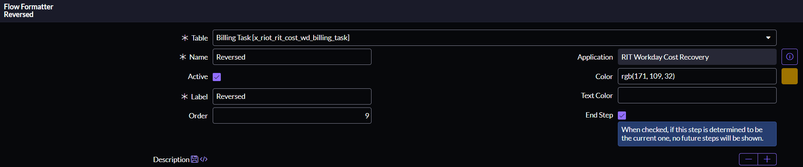

Setup of the color from within the Flow Formatter record.

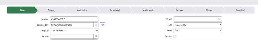

The resultant Process Flow UI, on the target record.

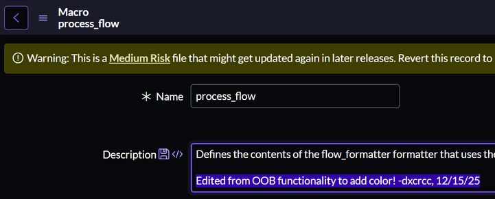

The UI Macro [sys_ui_macro] table stores Jelly scripts, that can be re-used across the platform, to transform inputs, into HTML that will render on the client-side. These are used widely by both OOB features, and in custom UI design. For Process Flow, specifically, the macro(s) we are interested in are (both) named process_flow, and are responsible for transforming a list of process flow steps, into the header UI seen on the record.
The Business Rule [sys_script], in our case, is how we "pass our Customization" to the macro. The design of the Business Rule provided below, is based around a set of OOB records, which can be identified using the following filter: nameENDSWITH_ProcessFlowList.
(e.g., https://[your_instance]/sys_script_list.do?sysparm_query=nameENDSWITH_ProcessFlowList)

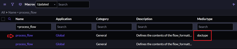

The Macro - OOB Functionality
As mentioned a couple times now, there are two UI Macros OOB, that both share the same name of process_flow. Both of these macros share the same style of pseudo-code, however, for UI16 specifically, the macro we'll look at has the sys_id of 4bcb4b840a0a0b9f00ae822ff0cef724.
Looking at the macro, there are a few distinct sections to digest, from the Jelly XML that is provided.

Customization - Adding Fields to Process Flow
Note: All configuration here should be done in the Global scope, regardless of whether you plan to use this for tables on scoped apps
First things first, we need to be able to store the data we want to feed into the display. For our use case, and for the purposes of this article, I will be adding two new fields. One for "Color", and one for "End Step".
To that end, navigate to the Flow Formatter [sys_process_flow] table, through one of the following means:
- sys_process_flow.config in the filter navigator
- System Definition > Tables, filter for name=sys_process_flow, open the record
- System Definition > Tables & Columns, find Flow Formatter > Edit Table
Add the respective fields to the dictionary entries/columns, as below. Names and labels are up to you, however if you choose to use other names than below, make sure you update the script(s) accordingly!
- Color - Changes the color of the step, when it is active.
- Type: Color
- Label: Color
- Name: u_color
- End Step - If checked, and the current step, no future steps will be displayed.
- Type: True/False
- Label: End Step
- Name: u_end_step
Once you do this, navigate back to the Process Flow definitions you created earlier, and set your Colors and End Step flags, accordingly.
By default, these fields will be placed at the bottom of the form. You may want to change this, to place them with the other configuration options.

There are two UI Macros provided OOB, that both share the same name. The one we want to clone, is the one which has the Media type of doctype:
(Alternatively, you can look for sys_id = a34bba13c3332100b0449f2974d3aeba).
Editing OOB files sets us up for failure in future upgrades, however, due to limitations of the platform, ServiceNow does NOT allow multiple UI Macros with the same definition, to be in the system at the same time. This limits our ability to "clone" this file, and we will, unfortunately, have to edit it inplace. With that said, it is a good idea to put a note in the description of the Macro, noting why it was updated:
Note: Due to potential differences between SN versions, it is rather difficult to provide a fully functional script that I can guarantee will work with specific release versions. As of writing, we are on Xanadu, and the scripts provided will be based on that versioning. If you are on a higher release of ServiceNow, I would recommend looking through the GitHub resources linked below, to see if you will need to "re-make" a new version of the Macro.
At a high level, there are three distinct additions/changes that we need to make to ServiceNow's code. The first, is a parsing block, to deal with our new color parameters. This can be added right below the

When you load a record that in "in" a step, with a custom color, it will be displayed in said color, at the top of the screen. If the current step is marked as an End Step, no "Future" steps will be shown.
Before:
The Flow Formatter, as configured with custom options:
And after:
