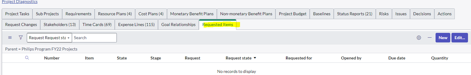

I have added a project field to the sc_req_item table and a related list to the pm_project table for sc_req_item.number. I am trying to create a business rule for it to populate this related list with the sc_req_item.number if there is a project populated in the req item. I am pretty new to the platform and have tried several things from other post but none seem to be working. Attached several pictures below, I just want that related list to populate with whatever req item numbers that project is on.

Thank you for your response, I already have the related list on the project table. I am attempted to make that list auto populate with the RITM number I have the specified project listed on. I attached some pictures below, basically if I populated that project field on the Request item I would like it to auto populate that related list for that project with the RITM number. Any idea how to achieve that?
Jon

I can manually select an RITM from the related list, but it does not auto populate for whatever RITM I put that project on. I think I may need to create a business rule, but I am not proficient enough in scripting to know how to write the script to accomplish this goal. Any other thoughts are much appreciated!
Jonathan

Something like this? Forgive me I am new with JavaScript and still learning any assistance with the syntax would be helpful. If the relationship already exists, would it be better to use a business rule?
(function refineQuery(current, parent) {
	current.addQuery('number', parent.sys_id);
})(current, parent);
