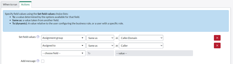

Or your can try to achieve it without script also from Action section as below:
You can use your Default Group field instead of Domain. It was just for your reference.

Hi @Priyanka77 ,
As per the best practice you can achieve this using customizing DBR.
Write an Display BR on required form(e.g. incident).
In action tab Set field values as per the scan attached.
