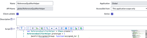

Check your initialization of the Script Include - just because your script editor is not formatting it exactly like what I am used to seeing:
Is your 'Group selection' variable a reference on sys_user_group?  If you manually filter a list view of the Groups table on active = true and name contains BK, how many group records do you see?  You can add some gs.addInfoMessage lines (or gs.info if that doesn't work in this case) to the Script Include to make sure it is running (not another SI with the same name) and confirm the value of the argument passed in from the reference qualifier, as well as if the GlideRecord returns any results.
The only other thing I can think of is to try a different array name - maybe 'list' is a reserved word?

Basheer
Hi @nakamura323
I can think of giving the api name instead of just name in your reference qualifier.
you have given it as new u_mids_test_id instead try the api name(you can see below the name field in script include)
