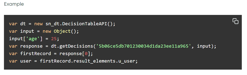

The way you are calling the decision builder is correct, you just need to add one more line to fetch the output
var firstRecord = response.result_elements.<output variable name>;
Please refer to example provided in the image below:
