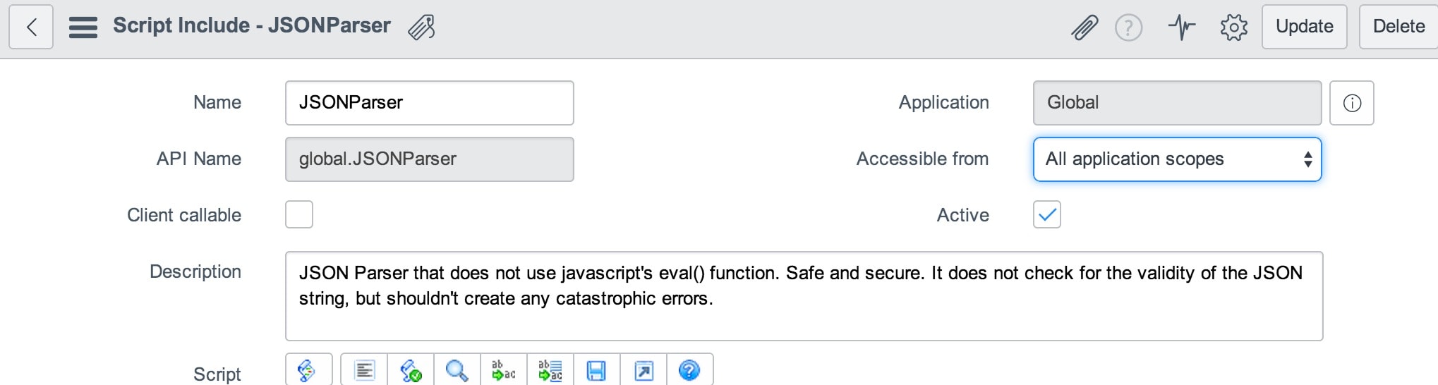

Pradeep Sharma
Hi Yogesh,
Please follow the below steps and let me know the outcome.
Go to the script include->Search for JSONParser->Now make sure the field "accessible from" is set to "All application scopes". OOB this is set to be "this application scope only".
Please find the screenshot attached for reference.

Pradeep Sharma
Hi Yogesh,
Hi Pradeep,
Yes, I had checked it but I did not want to change OOB Script Include.
